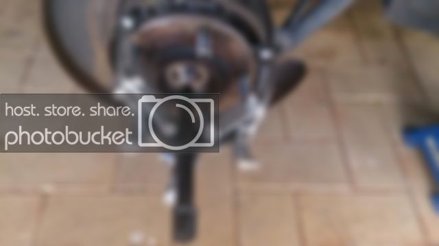

    Finally getting around to getting these done.
    I have got a reversible bearing/gear puller, on the attached pic below, is this the correct way to get the hub off?
