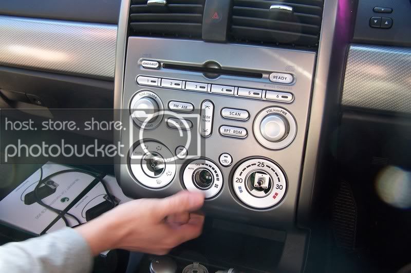

OK, first, remove the knobs for the climate control, and lift the faceplate off. There are three clips up either side, evenly spaced. Best bet to start lifting from the bottom in each corner.

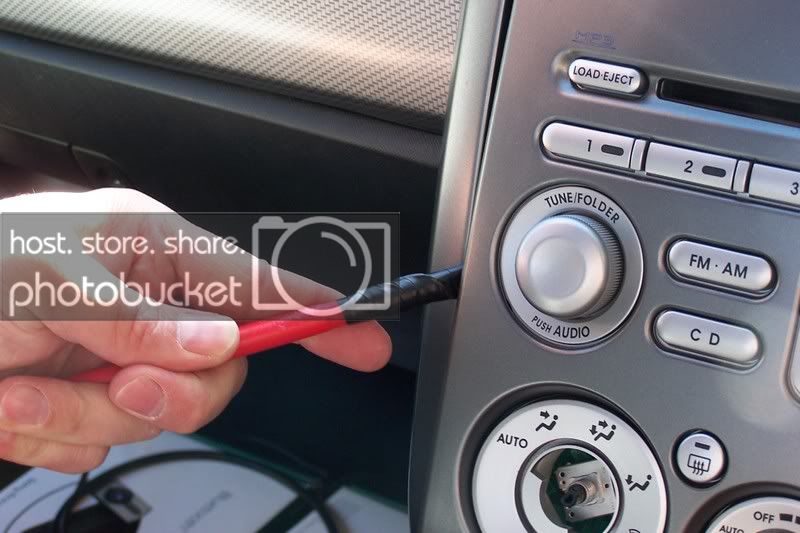

You may need to use a screwdriver with some electrical tape or similar for the stiff upper clips

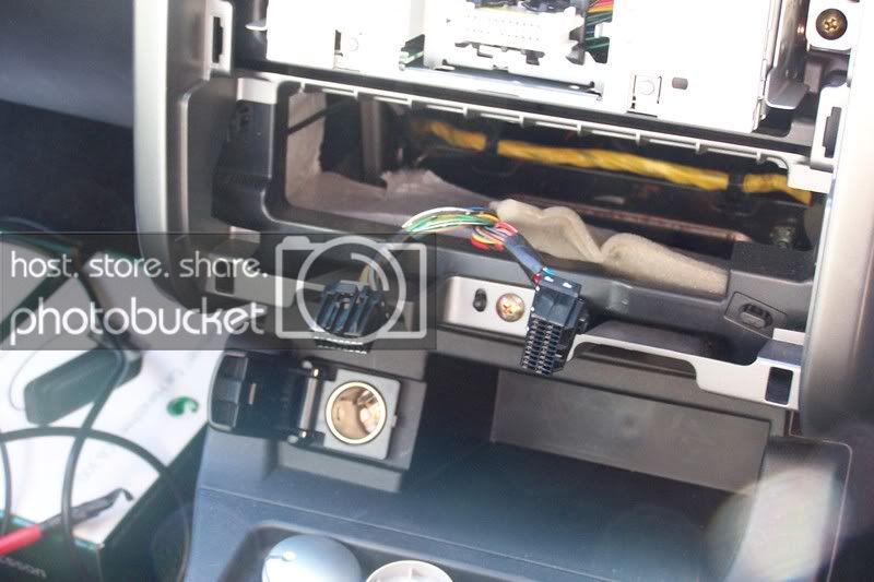

After, it should look like this:

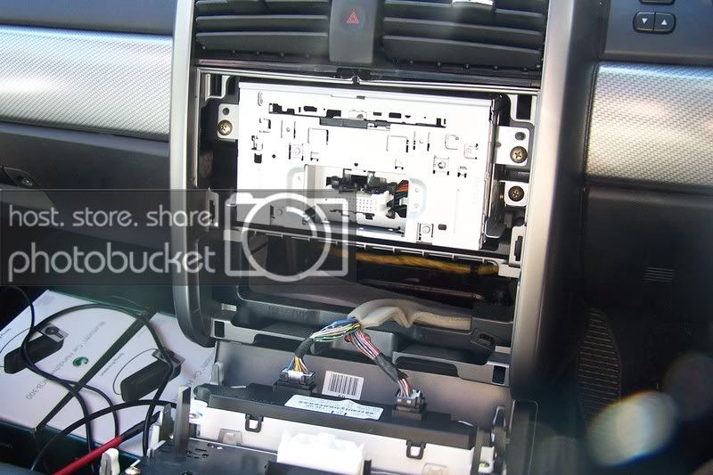

Unclip the climate control:

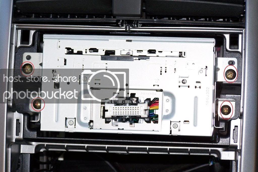

Remove the four screws circled in red, two each side:
