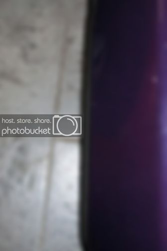

    Lugo, would it be possible for you to take a photo of you front wheels from the top, over the guard to see how much the tyres are protruding. Hopefully mine won't be as bad. I'm going for an RJR 18x8 +35 offset with 225/45R18 tyres which should protrude 5mm less than yours does.

    Quote Originally Posted by vlad View Post
    Cheers,
    Vlad
    It's all the tyre that protrudes, the old MA-V1's I used to have didn't protrude at all, the Dunlops on the other hand, well you can see in the photo. Measures about 3mm, sidewall is 5-6mm thicker than the Maxxis that were on these wheels.

    Thanks for that guys. Will post a pic tomorrow taken from the top as well for comparison.
