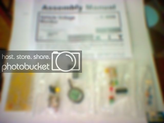

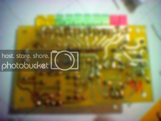

    Kit and zippy box
    All parts layed up for checking if complete before starting.

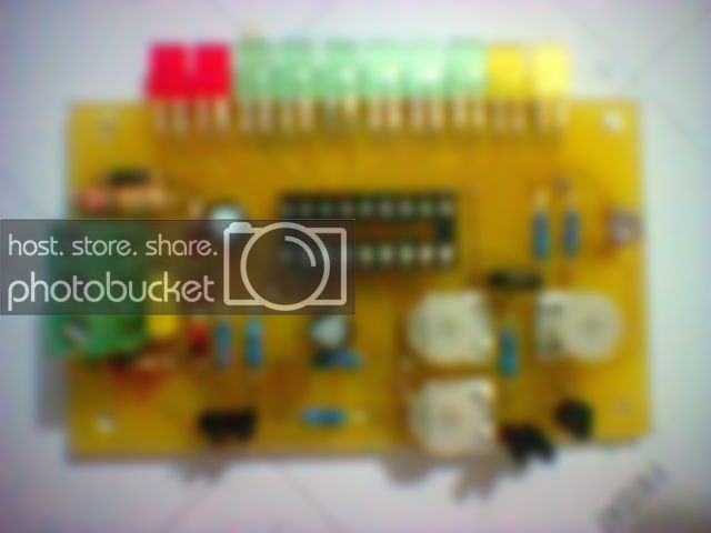

    In-process of soldering the parts.

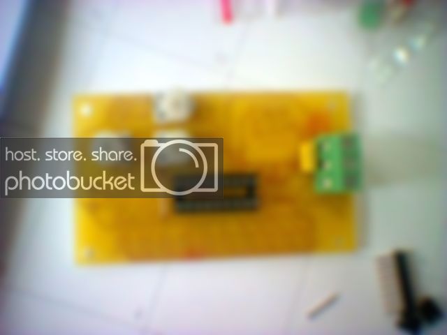

    All soldering were done, just needed to sit the IC.

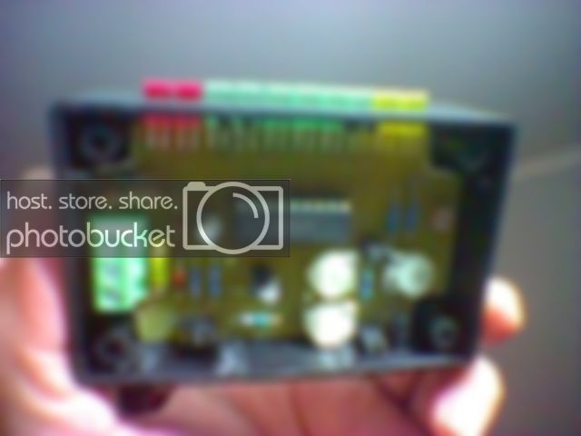

    This is how I soldered and connected all the parts.

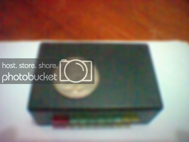

    This is how I fitted the pcb inside the box, little mod in the box and the pcb.

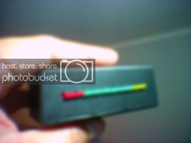

    Box with $0.20
    Now ready for installation
