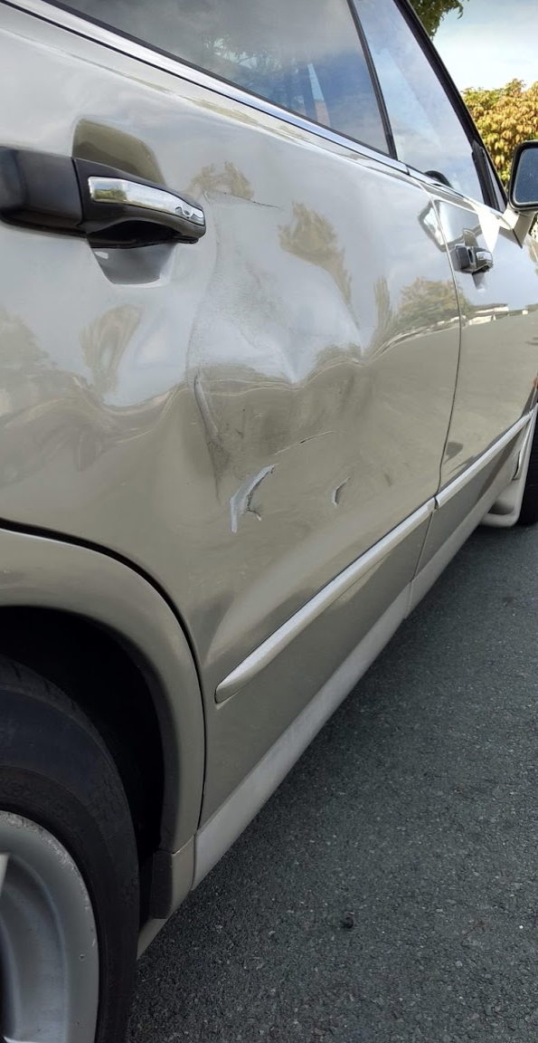

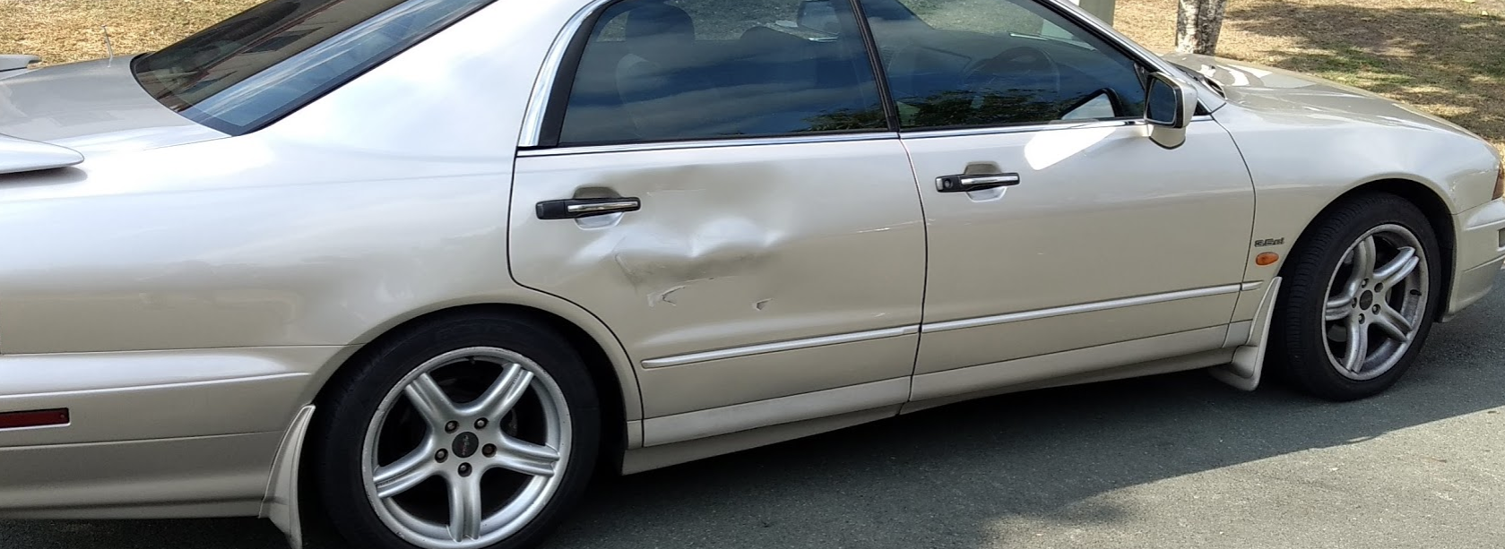

    Neighbor backed into my 'very' well maintained KF. Needless to say, not happy. And given the strange colour-changing properties i'm likely to believe it would be impossible for a replacement door to be resprayed to match as it varies between silver and gold depending on time of day and how you look at it
    What are the chances of finding just a replacement door? Fortunately the damage is just there, but a respray would mean doing that whole side of the car. If on the other hand a replacement door can be sourced thats the same colour, it should bolt up and look close enough to its original condition. There's only a little bit of damage that goes beyond the door area, small enough for me to not feel the need to respray the car if a replacement door in the exact same colour can be sourced

    For such a well maintained exterior that damage is a real pity.
    Hope you find a satisfactory solution.

    I have the same colour (Kashmir HH) and had a moron SUV driver pull out of Bunnings into my rear passenger door/boot panel last year. The damage wasn't as bad but the repairer managed to get a perfect repair and paint match/blend into the front passenger door and rear panel. I checked it in the sun and I can't tell unless I run my hand over the surfaces. I'd get the door repaired given how good your paint looks from the photo.

    I would try the interior handle first, then If that didnt work I would cut through the interior door trim to get to the handle workings and bend the cable back so it works. Obviously you need an open door to change it with a new one.
    Parts are easy and cheap so breaking something wont matter anymore.
    The ONLY difference in the metal pressing for doors is the L-W series have an extra beam in the door, and no holes for the lower trim to be clipped in. So otherwise, go for wagon, sedan, it won't matter. only the glass is different between the two.
