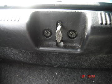

    It's not difficult.
    I will upload a photo' later today with some basic instructions.
    Aug 2014
    958
    You will need:
    1 x 10 mm socket & ratchet and/or medium-large sized phillips head screwdriver.
    (my image service is not working at present- maybe later - so for now you will have to get by without the images I took)
    Open boot;
    Look down;
    You will see the 2 x bolts and latch located on the horizontal section of the bodywork structure upon which the rubber seal and plastic trim guard is attached;
    Gently undo the 2 x 10mm bolts securing the latch and very gently move the latch plate slightly - I would suggest downwards initially - but this depends on your specific situation;
    Re-tighten bolts;
    Close boot gently and check if it seems easier to close;
    Re-try adjustment procedure until boot closes securely and easily.
    There is not much to it really.
    EDIT: Also make sure that the rubber seal has not been moved upwards somehow.
    It is unlikely, but check just to make sure.
    EDIT II: Image added by using different image host. It appears "Tinypic" is now "cactus".
