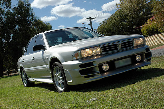

    Default Checking Headlight Types - 2.6EFI Sedan
    Non Xenon....1995 TS 2.6EFI Manual Sedan
    I understand we have 3 bulbs
    -Parking
    -Low
    -High
    The Low/High are separate bulbs...as opposed to some other cars which have both elements within the one bulb.
    Now
    One supplier has the H1 55W
    Does it just require 2 of these to replace my high and low beams no one side?
    In summary - my manual doesn't specify which bulb - so I'm looking for a short summary spec.

    TR/TS Magna takes me back 20 years but I believe the headlamp unit consists of H4 60/55W dual filament, H1 55W , 5W T10 Wedge parker . You're incorrect about the low/high bit. Still has low /high on the primary lamp and then the smaller with the 55w H1, lights on high along with the main lamp .
    Have you looked at these with high beam on?
    You could always remove what's in there and check what is fitted. Just don't touch the globes with your fingers as it can create hot spots resulting in premature failure. That may be a myth but that's what I was lead to believe.
    https://www.narva.com.au/products/globechart
