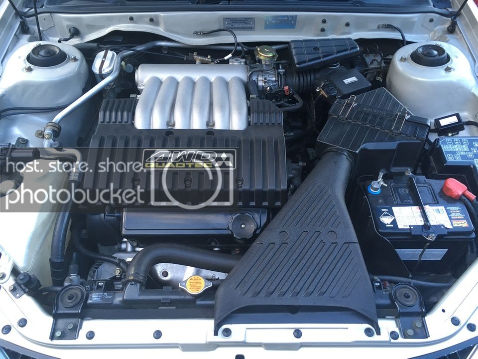

    The transplant is now underway should be done in the next couple of days!
    This is a stressful time for me while my KL's in 'intensive care' like this and I cant wait for the result.
    Attaching the "before" pic. Yes you've all seen a 6G74 engine bay before, but I thought it would be good to take a pic before it changes forever. I'll also post the "after" pic once done.

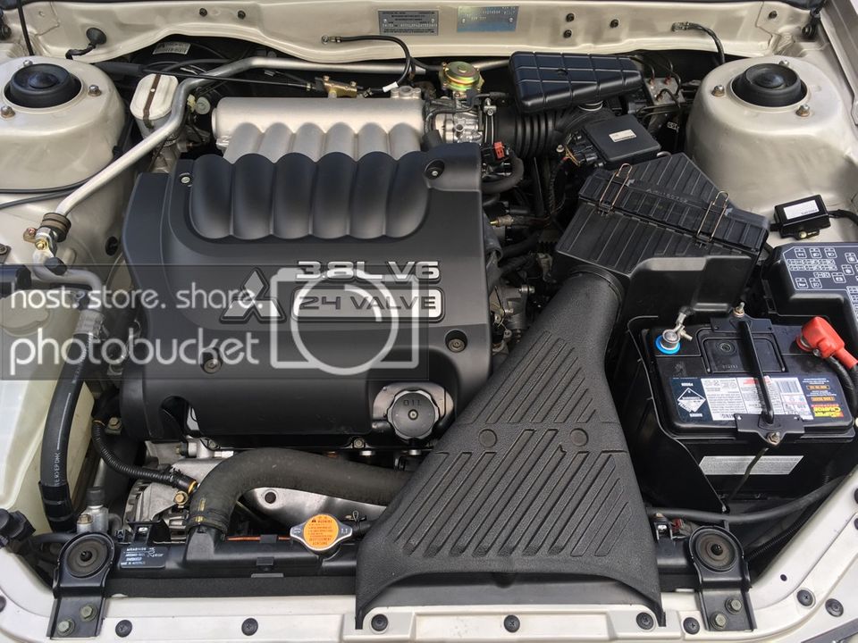

    The transplant is complete and the 6G75 is in!
    First impressions, (and apologies for the non technical description):
    Theres a lot more power available and the car quickly and smoothly gets up to speed with minimum fuss. With the 6G74 planting the foot from stand still would result in a rapid take-off but after that the RPM would quickly climb and peak loudly without much improvement in the speed. With the 6G75 speed increases beyond that point with a feeling of spare capacity available if I kept the foot down.
    I can also now break traction in the wet, but only just! If I put the foot down hard one or two wheels front and back will sometimes chirp once and then traction is immediately regained with no loss of control or poise. This is with the Yokos which I've always found to be very grippy in the wet on both the KL AWD and KH FWD.
    At speed theres also good capacity available for overtaking, whereas the 6G74 would overtake more slowly with a feeling of being held back causing me not to try in many cases.
    Noise and vibration is very good, with maybe a very slight increase to vibration as felt through the steering wheel, however the mounts were replaced, so its not an apples to apples comparison. I'd like to give the new mounts a little time to "settle in" before a final say.
    The motor is a little noisier at idle, (with hood up and head down listening) which I think is due to the different cams noises.
    Once again big thanks to Mal and his team at Mits Fix, its a fantastic job and I'm very happy with the work. Engine bay is very neat and clean with no issues. (See pic previous post)
