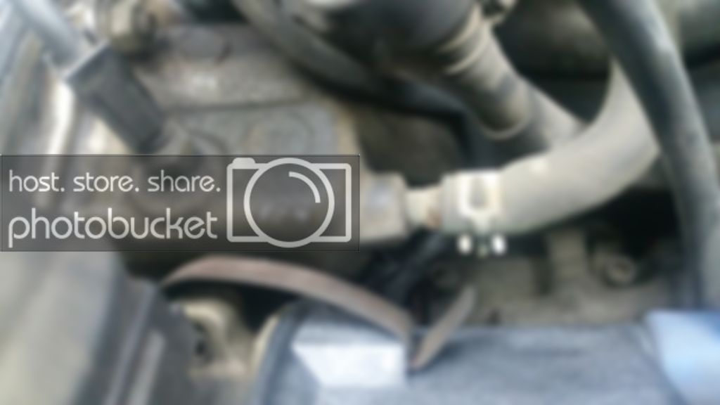

    near the distributor on the top of the inlet manifold and post them up

    Cheers. Will have a look tonight

    You're correct Buffy. Has two sensors one on top and one on the bottom which is hard to see in the pic.

    one of those sender wires goes to the automatic
    the other sender is for the temp gauge on the dash
    pop one connection off to find the gauge sender
    leave the automatic temp wire off and see if it makes a difference

    It's been fine for the last couple of weeks
